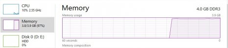

My desktop when opening multiple tabs on Chrome gets stuck and in overall behaves slow. I feel the RAM has become old and need to be replaced. I use desktop mainly to watch classes on YouTube. So when I play a YouTube video it appears stuck in between(Not because of streaming). I assume its not the issue with SSD. Please refer the attached screenshot and advise.

It's because your system specs. Low end cpu, not enough ram and 128 gb ssd is quite small these days. Time for upgrade whole system
Couriant
You haven't given much detail on your machine, but JohnB is correct. The biggest culprit here IMO is the 4GB memory, which I assume you are on Windows 10, and it's not enough. At bare minimum you should be on 8GB. On top of that, when the physical memory is used up, the computer would turn to the storage drives for help with memory functions. This in turn (at least with the older mechanical drives) would make the storage drives work harder.
The other culprit is that you may have not had a clean install for some time. I see that you have a secondary hard drive which I assume you store your data there so in theory the SDD should work, but that may also need to be replaced if you are currently out of room.

Yes, I am on Windows 10 and its time for upgrade. I have 100 GB free space left in C drive(SSD) and mechanical drive is where I store my documents and tutorial videos. But it was working fine until last week. I am busy with exams and can't upgrade right now. So if you could narrow down the issue to SSD or RAM, I will do the needful. But again I think investing on a DDR3 RAM is not wise as I intend to upgrade.

Your main issue right now is the ram. Having multiple chrome tabs open doesn't help either. How can you still have 100gb free space when 20gb is needed for Windows 10 alone. I'm sure you have other programs installed as well. A 128gb drive will only have about 119gb of actual useable space. Downloading and running Malwarbytes and Ccleaner may help with your slowness as you may have malware and/or unnecessary files on your system. Also stop any unnecessary programs from running at bootup by using the startup tab in task manager.
