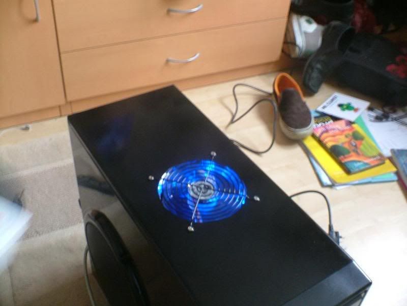

Get a hole saw - it is quite easy to get a 70mm hole saw. If not do what i did and get a jigsaw and just cut a hole out with it. Turns out ok. Heres mine

First i measured everything perfectly. Then drew the circle outline. Drilled a hole on the edge so i could get the jigsaw blade in. Cut around the circle outline. Aligned up the holes and drilled for the case fan screws (4mm) Then i got a dremel and sanded down the edges because, yes, they were rough and sharp. Then a wiped it down, repainted it as it got scratched whilst being cut. Put ill al together again and voila. Id go with a 12cm fan rather than a 80mm fan if possible.
